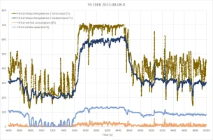

Was the engine doing DPF regeneration? I'd like say it probably was - only then the temperature at catalyst inlet (=turbo outlet) can get high eventually - but still 800 °C sounds dangerously high (above pure aluminium melting point) as the temperature entering the turbo is even higher.
(A) Observed exhaust temperatures at full blast (engine normal run)​
I can't get even 450 °C at catalyst inlet (=turbo outlet). See below two 20 second pulls - pedal down to the floor. Engine revved from 1600 to 2300 RPM at 7th gear.
Note: the plot over 150 seconds.
(B) Observed exhaust temperatures during DPF regen​
By doing DPF regen at fairly good load - by driving 130 km/h = 80+ mph - the temperature a catalyst input (=turbo outlet) gets siginificantly higher (peaked at 630 °C while before the turbo a maximum of 710 °C was seen.
Note: the plot across 3600 seconds (1 hour)
(C) Observed exhaust temperatures at full blast during DPF regen​
A plot at similar conditions as in (A) - though the pull was done only once. A kind of interestingly the exhaust gases at catalyst inlet (=turbo outlet) actually cools down a bit - presumably by the huge amount of intake air travelling through turbo.
Note: the plot across 100 seconds. The start/end of the pull can be identified by the curve of fuel instaneous consumption.
EDIT: High exhaust temperatures were observed also in the post below - on a remapped engine.
