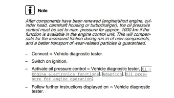

Brought the van home and decided to take on the job myself and in the process do a EGR-delete to protect the engine and maybe even DPF-delete. Prior to swapping out the turbos I was wondering if anyone know if you can set the oilpressure to max according to the workshopmanual with a tool like Carista, OBD11 or VCDS? I´m keen on doing this the right way as I probably cant afford another mishap, but maybe this stage isn´t always necessary?
