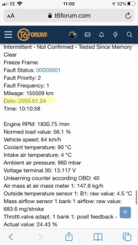

im also getting this 31130 fault regularly as below.
Address 01: Engine (2D2D2-CXHA) Labels:. 04L-907-309-V2.clb
Part No SW: 04L 906 056 KL HW: 04L 907 445
Component: R4 2.0l TDI H02 3802
Revision: 23002001
Coding: 00194014432401090000
Shop #: WSC 54478 001 1048576
ASAM Dataset: EV_ECM20TDI03004L906056KL 004003
ROD: EV_ECM20TDI03004L906056KA.rod
VCID: 0109FA3C9070C88C0D-8054
2 Faults Found:
16056 - Oil Pressure Switch
P164B 00 [108] - Malfunction
Intermittent - Confirmed - Tested Since Memory Clear
Freeze Frame:
Fault Status: 00000001
Fault Priority: 2
Fault Frequency: 1
Mileage: 154736 km
Date: 2050.01.19
Time: 09:59:17
Engine RPM: 1872.25 /min
Normed load value: 74.9 %
Vehicle speed: 42 km/h
Coolant temperature: 35 °C
Intake air temperature: 10 °C
Ambient air pressure: 1000 mbar
Voltage terminal 30: 13.312 V
Unlearning counter according OBD: 40
Air mass at air mass meter 1: 230.4 kg/h
Standardized air flow ratio: 1.007 counts
Exhaust recirc.valve 1 bank 1: posit.feedback - Actual value: -27.60 %
Throttl.valve adapt. 1 bank 1: posit feedback - Actual value: 0.00 %
Charge air pressure: specified value: 2.181 bar
Absolute intake pressure: 225 kPa abs
Mean injection quantity: 44 mg/stroke
Index of current engine mode: 0
Index of next requested engine mode: 0
Index of engine target mode: 0
31103 - SCR NOx Catalyst Bank 1
P20EE 00 [100] - Efficiency too Low
Intermittent - Not Confirmed - Tested Since Memory Clear
Freeze Frame:
Fault Priority: 2
Fault Frequency: 1
Mileage: 155509 km
Date: 2050.01.24
Time: 10:10:58
Engine RPM: 1830.75 /min
Normed load value: 56.1 %
Vehicle speed: 64 km/h
Coolant temperature: 90 °C
Intake air temperature: 4 °C
Ambient air pressure: 960 mbar
Voltage terminal 30: 13.117 V
Air mass at air mass meter 1: 147.6 kg/h
Outside temperature sensor 1: B1: raw value: 4.5 °C
Mass airflow sensor 1 bank 1 airflow: raw value: 683.6 mg/stroke
Throttl.valve adapt. 1 bank 1: posit feedback - Actual value: 24.43 %
NOx sensor before SCR cat conv: offset correction factor: 0 ppm
NOx sensor after SCR cat conv: offset correction factor: 83 ppm
Reducing agent quality sensor: urea concentration: 0.00 %
Reducing agent quality sensor: raw temperature value: 0.0 °C
Readiness: N/A
Reactions: mmi
