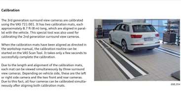

I just ordered the Calibration-Sheet as simple Plotter Print on DINA0+++ Paper
Lets see how that works.
Although I could use my daughters' art skills to draw it I have decided to use local printing specialist.
It is going to be ready for collection tomorrow and I hope it is well spent €20 :eek:.

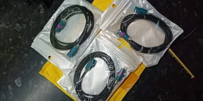

At first I am going to use it for my "highline" reversing camera mod
and then eventually switch over to "Area view 2".
Although these connectors are "CVBS" and not "RGB"(as required for "Area View 2" camera terminations)
it is a very nice compilation, showing almost full spectrum of FAKRA notched connector types and colours.
Thanks to @dnoermann 's research we know that there is even more complex calibration required.
Not necessarily the same generation but example can be seen below.
And I am going to dare to share.
All required calibration templates attached below.
It is a Corel Draw file but can be viewed & tweaked with Inkscape as well.

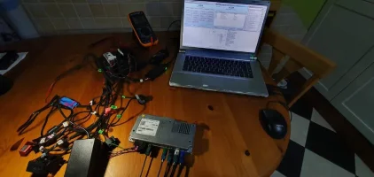

Eventually I have managed to perform my bench test.

Next step is Data Set upload and I am convinced that Sharan 7N is going to be the most appropriate
as its wheelbase is 2920 mm and this is only 80 mm short to T5/T6 SWB of 3000 mm.
Passat B8 wheel base is 2791 mm and data set from that vehicle would be too far off.

You have quite an impressive testing setup!;) Is there GW connected, I can't see it in this picture? Did you manage to get an image already, or in other words, I see that FAKRA is connected on the Area View unit, but where does the other end goes?!:cool:
Yes Can Gateway is connected, actually on PQ25 platform there are three controllers in one box(BCM-09, CAN GW-19 & Battery regulator-61).
To get image you need DM and IC connected to CAN network and I am too lazy to pull these out of my vehicle.
