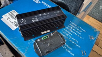

Ablemail AMT12 installation

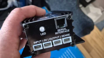

So I have now joined the Ablemail massive. Question re programming. It says disconnect the power and then connect SW1 to leisure. Does this mean pull the cables off the AMT or switch the power off and connect SW1 and turn power back on. At the minute I see the LED flashing green steadily about every 10 seconds
I didn't change the settings. It works perfectly on default setting 4!

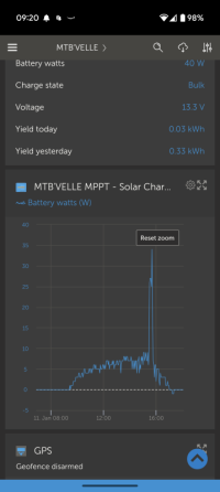

It is quite surprising how quickly the voltage increases when the panel is exposed to daylight, not even sun, quite murky here this morning and the voltage has gone up well already.
This was in January, LB at 45% and solar barely 10w for most of the day, Ablemail didn't charge over night but as soon as MPPT was getting a few watts that was enough to raise the voltage and start the charging again.
