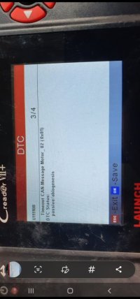

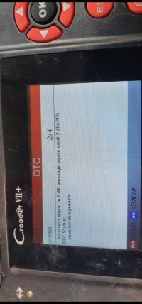

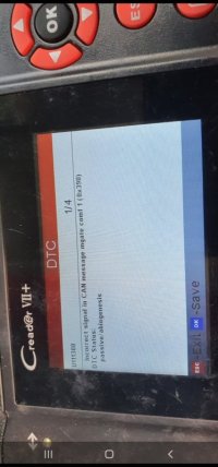

So today I have had 3 errors lights appear.
ABS, stability control and Tyre Pressure warning lights on, image attached.
is there any generic software I can use on an iPhone/iPad to check the OBD port for error codes?
I have a wireless OBD module and also ELM Cable for Ford vehicles, I presume the latter is same on VW as I thought OBD was a standard interface.
Possibly a wheel speed sensor.....

I have the same warnings and been told it’s an open circuit fault. VW told me it’s behind the rear light cluster and they need to investigate to find it which isn’t covered in the extended warranty I took out. Are you saying that you changed the abs sensor on the back wheel and that cleared the code? If so that should be covered by my warranty.
It sounds like VW have already determined that there is a wiring fault (open circuit means a broken wire) on one of the ABS sensors - so changing the sensor may make no difference.
Also double check if it's just a case that investigation on it's own isn't covered, but that it would be if the fault that is found is a warranty issue.
Yeah vw have said open wiring fault but the road side recovery and my Carista says wheel speed sensor so I dunno if they’re just trying to avoid a warranty claim. Wonder if my local garage could investigate for £40 an hour and then claim through the warranty if it’s a sensor.
Well a code reader can't tell you more than the fault code logged - and the most an ECU can tell you is that a circuit is either open circuit or shorted - so the two things aren't at odds with each other, if there is a wiring fault then yes there will be a code logged against the item the wire goes to.
However if the VW garage specifically said it was a fault behind the rear cluster then they must have some idea where it is - because that's not where you would change a wheel speed sensor.
Do you have the fault details from Carista?
By all means have the sensor changed - they live in a harsh environment and it's worth a shot - just be prepared for the fault still being there if there is an issue along the wire. The diagrams in the VIP section may help you trace the wires if that's something you want to do.
