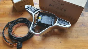

No yet, everything is bought waiting for heat, but maybe the price for encoding will be a little less, but for now it is very expensive 500 euros only for adaptation.20210215_120857.jpg

They reminded me about the cruise, and again I got a chill in one place and decided to call to find out how things are going today. :DThat's what you had to prove! Now I called to find out the price for today (500 euros is the price for December), said that I have all the equipment installed on the bus and only need to connect programmatically. The price was announced 200 euros, I'm shocked, the price tag fell more than 2 times, then I asked will this be done with the substitution of the vin number?, no, they say it was generated with reference to my vin number and when updating the car's firmware, nothing will fly off from the official dealer, they give a guarantee.
Result:Everyone speaks so beautifully that you just want to believe, jump into the bus and rush to them immediately.;)
