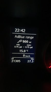

Evening folks.
Had a message to put adblue in at about 1500 miles to go, put the same amount in as I always do....and now the warning has stayed on and the range is decreasing rapidly. Done approximately 120 miles since fill and now range is 300 miles.
The only thing I did differently this fill (and I've done loads without issues) was I didn't start the van straight after filling, it was the next morning.
Any ideas how to get the warning to cancel and if not, do you reckon the van will actually stop at the end of 300 miles?
I put in 5ltrs and it asked for a gallon...I think. Basically the same as I always do...the last 7 or 8 times.
And what does it say to add now (normally says a min value and a max value)?

At the risk of stating the bleeding obvious, that message makes no sense.
It's saying you are low on AdBlue, but then says you can only put in 0.75 gals (min and max).
Anyone else got any ideas ?

Right....sorted.
It needed more adblue. I'd filled it to the brim and the warnings were still there. VW assist came out, said he knows what the issue is...he tried to add more but overflowed. He shook the van side to side then tried again...still overflowed. He tipped up the adblue and squeezed the container, big rush of air and the van gulped another 5ltrs.
Air locked!!
Warning now off.

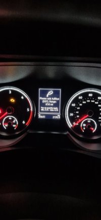

Hi how did you resolve this, mine has done the same. At 1200mile range it wanted 2.5 gallons min and 2.75 gallons max. I added 9 liters, so below the min. Nows it's asking for 0.75 max and 0.75 min with 800 miles to go.
I have travelled 300 miles since adding the 9 liters, so wait and see hasn't worked so fare.
Any advice?
Well, the post was just to demonstrate that even filling less than requested the new requested amount is updated - just the estimated range sticks with the old value for some time. That was resolved by filling a bit more. The threshold seems to be somewhere 3-4 litres for my van.
Anyways, your issue seems to be a different one as you filled way more than the threshold amount. And also a different than some have experienced - no fill amount at all - and range 650 miles and counting - with AdBlue spanner on dash.
I would put just more AdBlue in.
