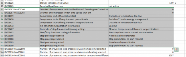

Here's a snapshot highlighting some strange differences in performances (compared with mine (Climatic)).
It looks like your compressor doesn't do much (see compressor current vs. achieved pressure vs. performance (temp at evaporator)).
The highest pressure I found in my logs (not here) has been (at +28 ℃ outside temperature) 14.6 bars (compressor current 0.82 A, engine idling).
Lowest temperature seen at evaporator 1.3 ℃ (today using MAX COLD).
Attached a file where your data from yesterday and today is compiled into one file.

Another interesting difference in the statistics - the mileage on my van is just slightly less than yours....
These "Interior temperature difference to specifications" and "Blowout temperature difference to specifications" seem to a kind of states before AC reaches balance ("Stop release" in logs). I don't know what conditions accumulate these - they look like counters for "condition not reached"
Scut​
mmi​
IDE03010-MAS02802Number of prevented stop processes-Interior temperature difference to specifications
1297​
40​
IDE03010-MAS02803Number of prevented stop processes-Blowout temperature difference to specifications
3408​
28​
