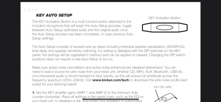

Hi there it’s a Kicker Key amp model 180.4
That’s the culprit. It’s got an in-built DSP and boasts ‘auto equalisation’. Somehow it’s been kicked into setup mode.
Manual says there’s a button on the mic. Where’s the mic? Could it have been accidentally pressed when you took the long corner?
