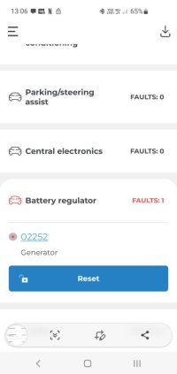

Does anyone have a guide to for service mode so I can change my alternator I am getting a regulator code and the alternator is not Charging. I have fixed a broken yellow wire from the positive of the battery to the alternator but still not joy which I believe is part of the smart charging system.
The van will start but will run for a little then stutter and die. New battery put on it. After 20 or so trys it will run but I have to keep it above 2000 revs to keep it going until warm. Then it will idle but when I press the accelerator it will run lumpy until 2000 rev. If I press the heated screen or aircon it will just stall.
The max voltage is 13.4 which is low I believe.

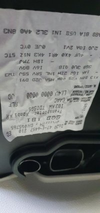

What engine code?
Post a picture of your build label from under the steering column.
dont worry I found it from your vin on your screenshot

The rac did a scan and all that came back was a regulator sensor. I went through water a month back at night which was around 2ft deep by accident.

Well yes.
That code could also refer to the oil pressure level and quality sensor on the bottom of the engine, get underneath and check the cabling and the plug for corrosion.
The battery regulator is attached to the negative post of the battery, but that won't stop it from running.
It would be better to get it scanned properly with better diagnostic equipment such as VCDS (as mentioned above)
13.4v is perfectly fine for a smart Alternator. The Alternator won't put out higher charge without a reason to do so, main one being high load consumers switched on such as HVAC, Headlights, rear demister etc. It will also not put out high charge if the charge is at the float stage, which is just maintaining the battery level. Have you checked what voltage the battery actually is when idle and when off? This could be helpful.
You're still about 10+ steps away from condemning the Alternator. Loads of things can cause fault codes that point to something but it could be the 45 things between.
It could be as simple as a LIN break between the Battery Reg and Alternator. You mention a broken wire between the battery and alternator, was this definitely on the battery positive? As the Batt reg is on the Negative post.
