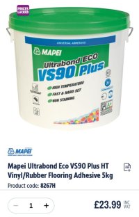

That's similar money to the Karndean HT adhesive.
Any thoughts on this Mapei adhesive? It's cheaper, gets good reviews and available in my local Screwfix, that's all!
Ultimately if the Uzin KE66 or Karndean HT will be much better for the extra £25, I'll go for it as it's negligible given the cost of the whole project. If they'll be similar then may as well go for the Mapei as that's also a good brand?
