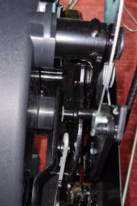

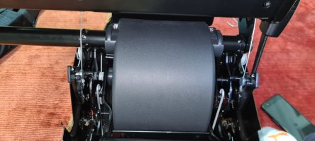

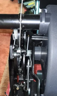

Can anyone here spot the problem with this single rear seat of my T6.1? That cannot be release/remove from its position.
