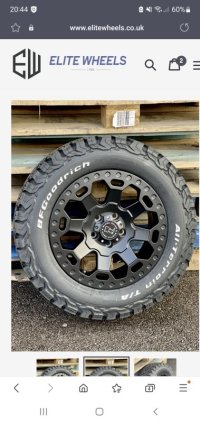

Hi Everyone, I'm looking at buying the Black rhino Warlord wheels and the BFG tyres but I have heard some say they are noisy, and some say they are fine. Any advice from anyone with experience in these tyres? Thanks.

Hi, BFG’s are certainly noisier than standard road tyres. You can look up their noise rating on most tyre fitters websites. On the plus side mine have just clocked over 40000 miles and plenty left on them so pretty good for wear. However, they are absolutely terrible on wet tarmac ! but then, that’s not what they are designed for is it?

That gives a guide but it’s not always the best way to compare. Continentals are generally high figures on the noise rating yet some models are quieter than say a Hankook with a lower rating. It’s not just the decibels that count but the frequency of the noise from the tread pattern. Varying block sizes helps here. It’s the same principle in train tracks - sleepers at an even spacing for huge lengths create a noisier track than a length where the sleepers are at mixed spacings.
Having said that BFG are blocky tyres, with big gaps, large volume (creates some reverb in the casing) and no clever frequency changes in the design. So they are noisy compared to road tyres.

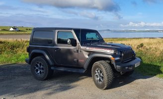

Had them on my Jeep Rubicon for a while, they were loud and had rubbish grip on road. Swapped for some Cooper Discoverers (ST Maxx) and they were really good, still looked very chunky and much improved handling and MPG. And a lot cheaper.

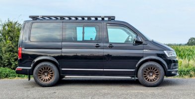

Nice tyres / wheels. Filling the arch nicely there. What size is that set up? Is your van lowered? Looking at Wildpeak, but can I squeeze them on my current 18” lowered by 45mm…

They're 245/65r17 - my van was low, it's now been raised back up
I'd recommend 23565r17 - you'll be fine lowered by 50mm, they shouldn't rub and they're only slightly smaller than 245/65 size.
If you're looking at 18" then I think 255/55 is the same size as 235/65 on 17" - or 235/55 in 18" is smaller.
That looks great. Don’t think I can buy another set of alloys back to 17”.
Like you, I don’t want the black van with the black alloys. But the gold looks good.
What wear do you expect to get out of the Wildpeaks. Only got 13k out of my 18” Bridgestone Touranza. Feel a bit hard done by.
Do you think the Falkens will do greater mileage, although a softer tyre?

I'd hope to get 20 or 30k at least, they're nice and deep on the tread!
That was my thinking, big deep tread…. Hmmmm.
Yeah, just measured - they've got nearly 9mm of tread! Minus the 1.6mm TWI, and obviously you won't been rubbing these down to the limit.
I only do 5-6k a year tops so these should last 5 years!
