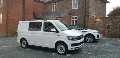

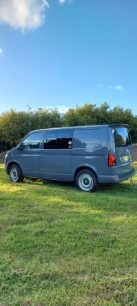

Evening bud, I have run both sizes and both work perfectly. No rubbing in any situation. White van is 55s and Grey is 60s 20190127_161800.jpg20200905_181954.jpg
