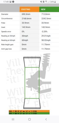

Hi all,
Just as some extra info which may be useful
I find willtheyfit.com very helpful when trying to match summer/winter wheels of different diameters, together with different tyre options.
Please see image below of a stock size (235/55/17) vs the Falken Wildpeaks in 235/65/17, and also vs a 235/60/17 option, (Cooper Discoverer ATT) which is closer to stock.
"Will they fit" is a useful tool. Just don't take too much notice of the alleged speedo errors!!
