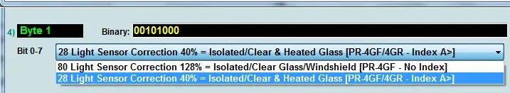

Yes, there is. However, the VCDS decodes suggest that the other options would work wrong way. Anyways, I haven't seen anyone verifying those, yet ;)
T6 sensor can be found in VCDS under 09-Central Electrics as a submodule. See below as from factory.
Another interesting one to experiment on the subject would be RLS byte 1. In the VCDS are documented only those values that actually exist in VW production (possibly even only on T6).
However, even just these two documented codings occupy already bits 7, 5, 3. Thus, one could assume that there could be other combinations available as well - implemented when the unit was designed to allow easy adoption later in production on different platforms/windscreens...
Obvious ones to try would be "F8" and "00" to see if they were even accepted - these two would be the max and min by using the upper five bits already allocated by two documented codings (1000 0000 & 0010 1000).
The new proposed values would be above and below current ones, so assuming correction scaling would be have a logical behaviour there might be a way to tune sensitivity up or down... possibly with some interesting side effects :whistle:
