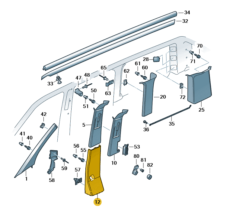

Morning All, Have a T32 73 plate combi. Have done a caravelle cockpit upgrade changing all the lower dash mon-rock grey to black as well as the door cards. Found on the VW parts website lower black trims for the B pillar. Does anyone know if these are easy to change?

Yes, if you’ve done dash and door cards you will be fine on B pillars. I seem to remember I had to take the upper ones off first when I was wiring my conversion, so you will need the splined tool for the seat belt top mount.

AFAIK there is no black variant for a Kombi, The black ones are for a Caravelle, which are slightly different to a Kombi and would also require the upper b pillar, door rubbers and the roof lining changing at the same time. :cry:
I wrapped my Kombi ones in black vinyl
