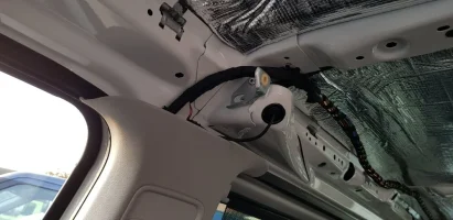

Here you go, only ripped out the back at the moment. Interest thing is that there isn't a grommet for a standard PV/Kombi pillar to pop into at the top. I assume the lower three are there which should be enought to hold one.
Perfect set of pics mate and explains everything. Looks like I'll need to source quite a few bits of pieces if I go down this route.As @Deaky said I swapped all my kombi to caravelle trim . The B pillar covers are different and the seatbelt mechanisms too . Here's a few shots I have from when I did mine ...
View attachment 100061View attachment 100062bottom one is standard van View attachment 100063kombi standard panelsView attachment 100064View attachment 100065The silver bracket you can see is in the standard van to fix the pillar too. not need in the caravelle trim
