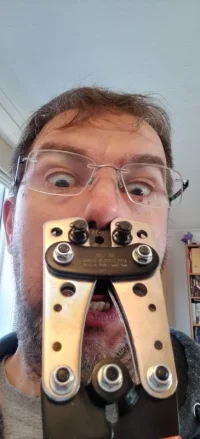

I have one of those yellow hydraulic ones (im a sparky) and find it pretty shit, last couple years i have bought a couple manual hex crimpers and find them so much better (and cheaper) no fluid to leak and not much to go wrong, will run out to van and add a pic of the one i am using at the moment
It does 6-50mm crimps so covers most things we need it for, got mine from 12v planet
