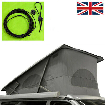

Not the bungee across the middle another one that goes all the way round the outside.
I pull the bungee right down at the front so it’s sitting on the van roof as I only want it to safeguard the back and found it got in the way of folding the front so it is tidy inside
Thanks, I was told not to use bungees around the middle of the canvas as it puts strain on the canvas at the bottom front corners where it’s siliconed?
This is ours. I have the front basically sitting on the silicon but it’s really not very tight at all. The air pressure caused if we were to close the roof with the doors closed would probably override the benefit. But it good to know it out of the way at the back. I also pull the sides forward at the front to be doubly sure

You can get 'bands' that go round the side to make sure everything is in. No experience of them but thought they were a neat idea.
