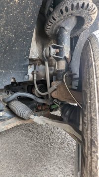

I'm looking to upgrade my 2018 Transporter 4motion 150cv suspension with the Bilstein/Eibach liftkit +35mm. I'm wondering if anyone has gone through this process before and has any suggestions on how it works in the long run and whats the feedback in general. Also, I would like to understand how I can know if my T6 is equipped with heavy duty chassis (1BH) or not.

Im pretty sure, from memory, the heavy duty chassis option int he UK is the T32 suspension - So bracket not clamp on the front shock absorber.
Send a pic of your front suspension if you want confirmation

Thanks! Mine is T28 so I guess it doesn't come with HD setup but I'll send the pic tomorrow. The price is quite high for the kit ~1900EUR I really hope its worth every penny!

Thanks, see attached photos. The van has a lot of options so better check!
