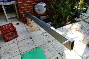

For practical and safety reasons I was not going to load the test springs to the full travel seen in the vehicle. But I made a device that was essentially a steel beam hinged to my house’s brick wall, with a reinforced wooden box to contain the spring and allow the beam to press down on it at a point 1/5 along it – and add weights up to 75kg at the outer end, meaning I was loading the springs with 5 times that, i.e. 375kg (about 825 pounds /lb). The compression distance was measured by averaging from 6 points around the rim of my pine box, at each stage, the distance from the rim down to the floating plywood compression end-plate.
Keeping the weights low was somewhat inspired by (1) cracked brick face on the house wall when I didn’t use enough anchor bolts for the pivot bracket; and (2) cracking of the first top plate when it was 19mm pine; 20mm 7-Ply was much stronger.
