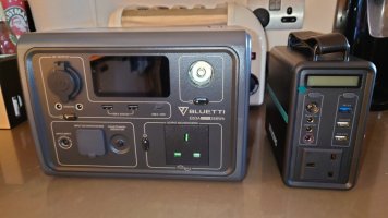

So this is the Bluetti EB3A alongside my small Beaudens I use as a secondary 12v system in my van that I've discussed on my tinker thread.
First things to note is though it is much bigger the capacity isn't hugely different (167Wh Vs 268Wh)
This is because the Bluetti has it's mains charger built in and has a 600w inverter (that needs cooling) Vs a 150w inverter (that doesn't). Essentially the bottom half is battery, the upper half electronics.

You'll note the Beaudens has the 240v socket sideways so it can stand up with a "normal" plug and strain relief in. The Bluetti has the socket in the "normal" orientation which means in the vast majority of cases it will rest all its weight on the cable strain relief, which is daft.
Even after is the obvious solution is to rest the unit on its back so the sockets are all on top - but the back is the only curved surface. I fixed this by putting 4 furniture felt stick on feet on the back but it's still a silly design error.
