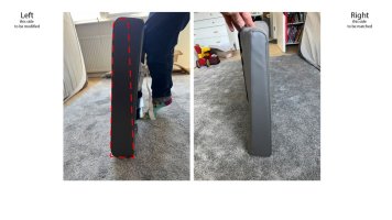

Your pic of the seat foam shows the angle I would need to cut so thanks for that.

I don't fancy chopping up my perfectly nice seats. So to get some quotes from the professionals I've put together some photos to help explain the seat mod to a metal worker and upholsterer. I'll drop them here incase they help anyone else :)
If I had to modify the foam I would start without modifying the cover, maybe just put the cover back on and see how much slack there is in the cover. It then becomes a problem like "taking in the waist on a pair of trousers" i.e. just cutting some flags into the cover and stitching back together.

Update: I’ve had my metal seatbase modified to match the angle on right hand side.
Seat now goes right to the back of the van Clearing the wheel arch.
A bonus is that the foam and upholstery probably don’t need trimming.
It feels like a LWB in there now :)
