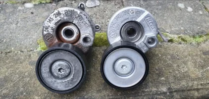

Have VW modified the tensioner to improve reliability, looks like the PN suffix has been changed from B to G?
I had warranty issues with my van (not belt tensioner) and I’m gobsmacked that they just replace the failed part with the exactly the same revision, only for it to fail again.
I was just looking at that. I wasn't sure if the two ears with the alignment holes had gone and then noticed there's a rod aligning them for ease of fitment on the rev G version.

Do you know the revision of your old and new tensioner?

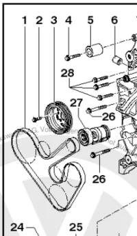

As usual, you are right againPerhaps the ETKA is for EU5 engines (CAAA CAAB CAAC CFCA):
