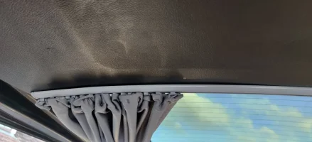

The rear was fine to fit and has come out well. I sat in the boot with the door closed. The upper rail sits next to the roof. I fitted then with the door closed so there was no risk of tting them where the two internal panels are next to each other, in effect causing them to distort. The lower rail was similar, fitted with the door closed so the rail would not crush between the inner panels where they come together.
As I may have said above. The self tappers worked fine. Don't over tighten them, just nip them up. The curtains are not under any great strain so no possibility of the tight curtains pulling the rails out of the plastic.

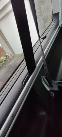

Hi again, ok here are one side of the rear side windows. I initially discovered these curtain rails are bent for screwing directly to the metal in the van. My Shuttle has the VW inserts/cards. I started by bending one of the rails to attempt to fit better but this just pushed the edges of the rails towards each other which prevents the curtain runners from moving past. Then if I just drilled and screwed holes in the metal rails and screwed to the plastic they are fine, and although I wouldn't pull hard on them, they are firm enough not to be pulled off moving the curtains closed and open again. I had to adjust this side, afterwards as I discovered the rail was restricting the return of the seatbelt. These curtains don't restrict the blinds either.
Again, these are the curtain kits sold by Kiravans. I don't have curtains for the side doors. But I don't anticipate any issues.

Thanks for the images, looks good enough, but I’m sorry, what have you screwed the top rails into? I have the roof lining only on the rear quarters (no seat belt on the bottoms) the bottom plastics are easy and no issue at all, same as doors, although in time the curtains will distress the plastic trim out of shape due to the tensions
BUT the top of the rear quarters is what we struggle with, short of putting some sort of wooden block underneath the lining for them to screw into?
Went in direct before and it pulled the lining down after 2 months
