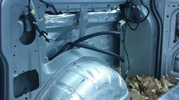

Took the pipes put completely, had to cut them in certain areas as impossible to remove with out a major strip down. Remove HVAC, blanked hole in floor. Shape a new piece of Ally on inner wheel arch where HVAC sat, so when trimmed wouldn't look too bad 'unit covers in so not the end of the world if left blanked hole in wheel arch.

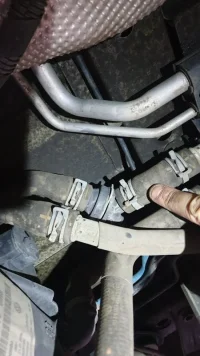

Removing the jointed hoses is easy and takes seconds. Anywhere where you make a break in the aircon pipes, such as removing the hvac or recirculating like you said. You will need to have the gas removed first.

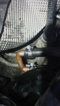

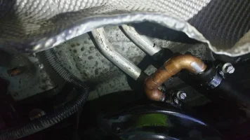

One to remember is the heating side of the HVAC, I clamped off the pipes near the diesel heater and cut them, made a U shaped bypass pipe using 2 elbows and small tails of 15mm copper with olives clamped on so the jubilees had something positive to clamp onto.
OEM diesel heater doesn't just do the rear HVAC it is also used to heat the engine when started below 5 degrees, so need to keep in place and working.

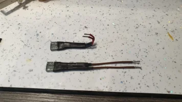

Curtiain airbags are another, remove them and bypass under the passenger seat using a 2.2 Ohm resistor. 20201212_134251.jpg20201215_125106.jpg20201215_125114.jpg20210113_130749.jpg20210214_152950.jpg
Curtiain airbags are another, remove them and bypass under the passenger seat using a 2.2 Ohm resistor. View attachment 132955View attachment 132956View attachment 132957View attachment 132958View attachment 132959
