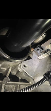

Hi this is my first post on ,been just using tofind out all about my Dreaded cfca engine in my T5 sportline 2013 , have spent over £7000 trying to get it fixed.What a want to find out is the my engine the right one that was ment to be rebuilt or have I been conned .The number on engine is 03L 021AP 80HBH V400, what drew my attention to it was I noticed different sump when trying to see were oil was leaking from also now developed leak from gearbox from engine side. Any information or help appreciated,.Mark

When i ask why different sump was told because of oil pick up , not sure what that is or means,but noticed because of different sump there’s bolts missing that connects old one to gearbox .what am trying to work out is the engine number from above a T5 cfca engine
There’s something way out. The bolt holes don’t appear to be aligned. If I were you I’d get an independent survey done or maybe someone you know
