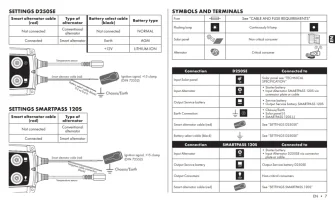

Hopefully easy to fit - The only thing that I am not totally clear on is changing the profile on the CTEK - I think it is as simple as connecting the black cable to a permanent 12v - Would that be best going straight to the leisure battery terminal?
yes just move the BLACK battery select cable from:
0v Ground - AGM
to
+12v - Lifepo4 ( any 12v will work )

Fitted battery and victron last night. All good apart from noticing that the installer hasn't attached the red wire on the d250se to the ignition!
