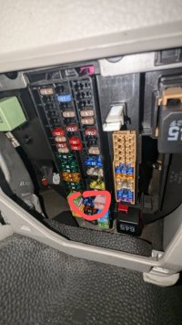

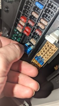

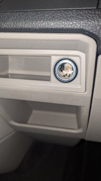

Hi I recently bought a 12v charger for my van to charge my e-bike from the leisure battery (bought from the UK dealer specifically for this bike) when not plugged into a mains EHU. I plugged the charger into a 12v cigarette lighter style socket connected to leisure battery and a green light came on showing the socket was working. When I plugged the other end into the bike battery, the light went out and I appear to have blown the 7.5A fuse. I'm hoping someone with better electrical knowledge or experience of doing this can offer some advice e.g. do I need a bigger fuse? Is there an initial surge current that the fuse must cope with?

100w divided by 12v is 8.3a.
So if it's trying to pull 100w from a 7.5a fused 12v socket, that's your reason!
I presume the 7.5a fuse is on the vehicle side, not on the charger? Swap out for a 10a - 12v sockets are OK up to 10a, anything more and you'll run the risk of melting them.

Well, 'technically' a 12v cigarette lighter is capable of 15a.
But technically you can do a lot of things which really aren't a good idea!!
Tbh, having an Anderson connector hard wired into your system isn't a bad idea as it'll let you connect no end of stuff in a much safer way than the 12v socket, and connect stuff over the 10a limit - like portable solar panels.
Tbh if you're only using it on hookup then I'd stick with 240v. If you want to charge it when driving along then go for the Anderson connector route.
I agree that cig lighters are rated at 15A, but that’s not continuous. Don’t forget that they were originally designed to be….a cig lighter. 15A for 30 seconds or so that it took for the lighter to heat up is waaay different to drawing 10A for hours. Personally I detest them & avoid using them whenever possible, the Hella type plug & socket is much better, but even then only good for 10A.
