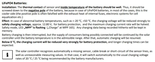

"The MPP-series controllers feature a second output so that some of the solar power can be used to trickle-charge a starter battery with a current of 1A max."
  • Nominal operating voltage: 12V DC
  • Solar module max. output: 250W
  • Solar module max. current: 15A
  • Solar module max. open circuit (OC) voltage: 50V DC
  • Max. charging current: 17.5A (aux) / 1A (starter)
  • Compatible battery types: Lead-acid (flooded, sealed), Gel, AGM, LiFePO4
  • Stand-by current consumption: 0.004 A
  • Over-charge protection: Yes
  • Reverse current protection (back drain at night): Yes
  • On-board mains suppression filter: Yes
  • Number of charging ports: 2
  • Protection against over-load, over-temperature, short-circuit: Yes
  • Connection for temperature sensor: Yes
  • Compensation for voltage loss on charging cables: Yes
  • Connection for remote display panel: Yes
  • Operating temperature range: -20 to +45°C
  • Overall dims incl. mounting flanges: 131 (W) x 40 (D) x 77 (H) mm
  • Weight: 235g
  • Manufacturer's article number: 1715
Part Number: MPP250
looks like there is 4x versions goin up in charge current.
Votronic, MPPT 165 Duo Digital charge controller - https://amzn.to/2Gr4g7q
Votronic, MPPT 250 Duo Digital charge controller - https://amzn.to/2sXG6hC
Votronic, MPPT 350 Duo Digital charge controller - https://amzn.to/2t4lGnm
Votronic, MPPT 430 Duo Digital charge controller - https://amzn.to/2O1yGkP
https://www.votronic.de/images/Manuals/07. Solar Current Technology/1710_1715_1720_1725_e.pdf
looks like it has LTD (low temp) too . . .
