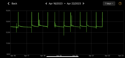

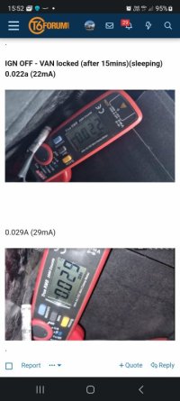

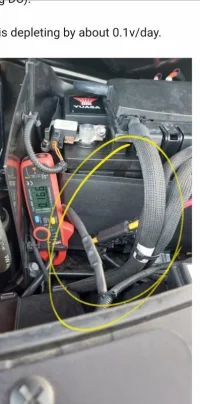

What's this fuse feeding?All checked again. No USB charging, no wifi, no dash cam, nothing on ODR port. Left to sleep for 60 mins, this morning, draw is still reading 0.166A
Excellent data. Will the fault code generated above 50mA draw give details of where the draw comes from ?
That's not OEM. Dc-dc charger?
Have you disconnected that to see what the reading drops to?.
