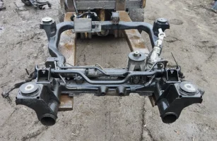

This handy pic off of ebay would suggest four bolts. One at each corner?
Is there any precedent for these working lose? I'm at the point where I'll check anything but I've not heard of this before is all.
Yes, 4 bolts. I know some golfs had issues with these bolts so no harm to rule them out. Check the 4 steering rack bolts while you're down there. And check none of the legs on the rear engine mount are cracked/broken.
We have only found one van that had sub frame bushes shot and it was a similar story , rebuild the van underneath and in desperation took the sub frame out , the 4 bushes holding it into the chassis had completely torn away , Oddly the noise wasnt that bad and it was spasmodic to say the least , so not sure it will be these , Massive job to do of course , Powerflex make the bushes .
