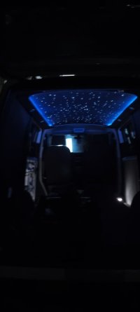

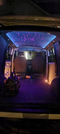

just after I've finish the ceiling as well.
