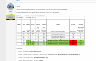

@mmi data plots below.
fuel rail pressure at shutdown . . .
was 29600kPa @ 820rpm tickover.
at shutdown rmp=0 rail pressure starts to drop.
by 20seconds later rail pressure dropped to half 1600kPa
by 30seconds later rail pressure dropped to min 800kPa
by 40seconds later rail pressure dropped to min 500kP
final resting rail pressure is 200kPa

Thanks, for this, I've had a good read through and it could be the problem. Once i have it started, i turn it off and wait a couple of minutes and starts again and again from there with no problem so its just the initial start thats the issue, so does sound like a full pressure related problem thats resolved straight away once started.
