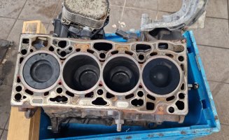

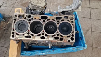

So the garage done another compression test, say they don't do them when engine is cold, as vw states "Engine oil temperature approx. 80°C."
But this is the new results....
They saying they need to do more tests, but looking like they need to claim on extended warranty for a new engine....
Keep asking for original compression results, but seems to be avoided. Asked about DPF and EGR to be checked, again no comment about...
I had a gut feeling when they done the HPFS that it wouldn't help. And now I've got a similar feeling about them saying it looks like its going to need a new engine...
This plus they seem in no rush to get it tested and passed to claim on warranty. ARGH
Whats labour time for replacing an engine? a lot of things need swapped over? and how does it normally work with getting DVLA to update V5C? Will it affect resale of van (losing love for it)?
