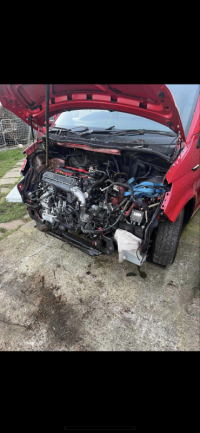

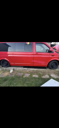

I have went the harder way converting in a 2006 t5
Modifyed a audi rs3 engine / 7 speed dsg gearbox / shifter / ecu / pedal box / servo / abs pump / canbus /cluster /also added t6 dash ( I didn’t add the bcm but gearbox works fine in manual and sports / manual shifting / long as gearbox sees abs signal for speed sensor no issuise , 525bhp , people telling me it couldn’t be done. , it can a bit of help/ knowledge. ,
That diesel Rev counter is going to flip out when you turn the engine on!!!
