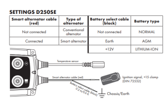

Thanks for your response. Some numbers:
ENGINE OFF RED WIRE ON POSITIVE FOR LI BATTERY
Li status - 73% Charge
CTEK Statis: Charging Starter Battery from Solar in 3s pulses (Implies Service battery full)
Starter Battery: 12.57v
Solar: 22.3v (in between pulses)
Service Li battery: 13.26 v (Current to battery 0A)
ENGINE ON RED WIRE TO POSITIVE
Starter: 14.29v
Solar: 22.3v
Service: 13.32v
Basically it seems to want nothing to do with the Li battery! Hence my concern about compatibility.

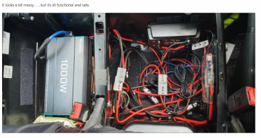

Wiring
Top left: Solar +
Bottom left: Starter + and RED battery select wire
Bottom Right: Service battery +
Top Right: Earth from both batteries and solar
Ideas?
Update - if I put the battery select cable (Black) - on to the (-)terminal for an AGM battery it starts charging properly from the Alternator at 2.5Amps (very low - should probably be higher)
I’ve isolate the solar for now. Makes me think the Lithium profile might just not be right for the Renogy battery.
Wonder whether I should bin off this CTEC as a lost cause and just by the Renogy DCC50s
Should the black not go to the +ve for the service battery connection (‘out’ - bottom right on your picture)?
Hi - thanks, the instructions are not specific on this. I have tried it there but will try again for good measure, thanks, Jim
On changeover, it changed from supplying the service battery from the solar panels 0.5A to deciding that was better given to topping up the starter battery. On starting the engine - it would charge the service battery at 0.5A only all three lights on. On turning engine off it reverted to giving the service battery 0.5a from the solar. The impression ai get is that the CTEK thinks the battery is full and therefore thinks it needs no charging…… is the CTEK just not suitable for this Lithium battery? - anyone else have this configuration working? Thanks, Jim

This morning I was able to confirm that the battery select cable is working - the solar panel were charging the battery at just 0.26 A but it was at the right voltage for a lithium battery. Removing it changed the voltage. So that’s all good. Starting the van resulted in the A lamp switching on but no additional current to my depleted Li battery. Ammeter on the Starter battery shows it starts with receiving 5A from the alternator but this then steadily drops to less than 1A as it becomes fully charged. CTEK just refuses to use the alternator, but will use solar.
If the starter battery is up to 80% then the alternator drops the output. If you put the fan on to setting 2 it pokes the alternator into action. My sterling b2b needs to see 13volts + before it starts charging. Also regenerative braking pokes the alternator.
Thanks, I’ll give it a go. CTEK seems to be limiting what it’s prepared to give from solar or alternator to just 0.5A. Renogy have confirmed that they would not normally use a charge profile like the one the CTEC gives out. Battery just wants to charge with a straight 14.2V - no profile. The issue might just be an incompatibility between the battery and CTEC.
