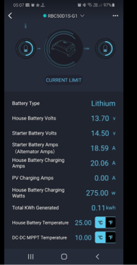

Update - Renogy and CTEK have the same wiring configuration. Uprated the fuses, swapped over the wires and hey presto, everything works as it should and of course with the BT dongle the Renogy tells me everything it is up to. On solar and Alternator it will give 25 amps from each. If you switch off the solar, it will give 50amps from the alternator along - that’s quick charging for a battery that will accept 100a. Job done.

Hi Blitz. CTEK still insist that it should work with Li battery, but it would not with my Renofy battery. Changing over to the Renogy charger (I think its on special offer too) with the Renolgy battery and everything was, and is still great. In respect of your cable you can set the maximum charge rate on the Renogy via the app. It's rated at 50Amps. If solar panels are connected then it splits this 50/50 between the solar input and alternator input - at 25A you can leave the cables as they are. If not using solar panels - or you have the ability to switch them off then 50A from the alternator is allowed, but you can still restrict the charge rate within the DC Home app to a lower value - so you do not need to change your cables. I have left my cables as they were but I did change the fuses to the recommended value of 60A.

as you say you can "current limit" the renogy DC charger with the BT-2 adapter via the APP.
20,30,40A etc

you will need to set the current limiter in the DC charger to say 20A . . . ( to limit the system to 20A )
and not rely on the SOLAR input being detected.. . . ( ia at night time it will ignore the solar input and move to MAX current - ie 50A, unless you set the limitter . . . to 20A)
and even then you are reling on firmware programming and no blips.
its fine to use in the short term . . . . but i would not feel happy using a 50A charger untill i had a 50A cable/fuse set installed.
safety first right . .
