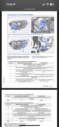

Depends on your headlights. Do you have H4 (with the DRL in the large reflector near the centre) or H7 with (DRL below the low beam reflector)?
They use different but standard bulbs and can be changed with reasonable ease.
For H4, it should be fairly straightforward. Excerpt from the manual below.

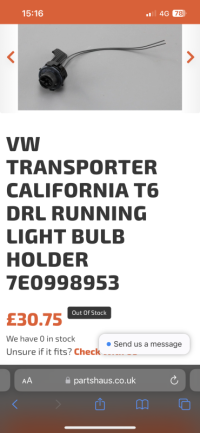

Yours are H7. There is an issue on these DRLs where the contacts can fail where the bulb holder attaches to the reflector. The fix is to remove the old holder, and splice in a new one, hardwired inside the light.

@Mr sean As yours is pre MY2019, the chances are the bulb holder will have melted. As mentioned earlier in the thread, this needs to be replaced with the updated part. The headlight needs to be removed to do this job.
I would go back to VW and tell them that this is a known fault and due to the part being proven as not fit for purpose, perhaps it should be repaired as a good will gesture. I guess depending on what sort of VW history rhe van has will determine what they have to say.
If they don't play ball, it's not a difficult job to tackle yourself if you follow the video guide from THQ. Whilst the bumper is off, it would make sense to replace the other side as well.
As someone on here pointed out and I then confirmed in practice, taking the whole bumper off isn’t necessary - can just do one side at a time. Makes it much easier to align and fix back, and only needs one person. Simple job really.
I used the VW DRL bulb holder repair kit on mine. Think it was 35 quid per side from memory. Once the headlight is on your work bench it’s a simple soldering job.
