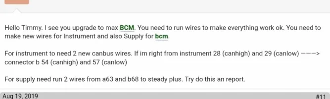

you need to remove and isolate the old wires

Yuo didn't connect the can bus wires correctly according to this scan, so you won’t be able to adapt the keys
Go to 19 >> installation list >> 65 tpms
Click on it then save coding
Double check your tpms wiring
