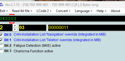

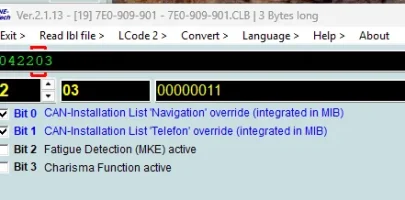

i ask hier....i instal in T6 discover media PQ. but i got a problem with PDC. first time when i start a car show in 5F...but then second one doesnt show any more....is it possible something with coding? anyoone have this problem what i have to code for this to work all the time? 5F or 10?
This working for me. On (19) Can gateway list only 5F checked and long coding:
