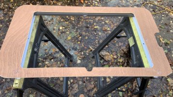

I couldn`t bring myself to pay for Vanshades so decided to make my own. I`m pretty good with diy but not with wood. My van was a startline which was ply lined and I kept all the panels when I stripped it to do the poptop, windows, sound deadening, insulation and carpeting. I decided to use the old ply so only parts I needed to buy was the blind from Ikea and a length of 38x25mm plastic trunking. It took me about an hour to make and i`m going to cover it with some 4 way stretch carpet I have left over from doing the rear of the van. I`ll post some more pics once I`ve finished them both.

I did a bit more this afternoon but ran out of time. I managed to build the second one and carpeted the first one. I also managed to fix them in place. I left them fitted for the drive home from Halifax to Manchester. The road out of the forest where I work is very bumpy and if anyones ever been to Halifax you`ll know how bad the roads are(full of huge pot holes). As others have mentioned the springs on these blinds do rattle so I left the instruction booklet tucked round the spring and I didn`t here a single rattle or vibration from either blind. There was the odd rattle from the offside one but this one hasn`t been carpeted yet. Here`s a few more pictures I took. I also painted the window side of the wood so it isn`t as visible from the outside.
