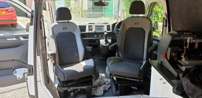

Small update on my golf seats, rusty lee swivel bases now fitted. I changed out the box section for flat plate to get them a little lower than they sat on the 50mm box, and had to move both seats into the centre of the van about 15mm but cant tell when driving so no drama there. Very pleased20210531_130048.jpg

Small update on my golf seats, rusty lee swivel bases now fitted. I changed out the box section for flat plate to get them a little lower than they sat on the 50mm box, and had to move both seats into the centre of the van about 15mm but cant tell when driving so no drama there. Very pleasedView attachment 117931
What thickness flat plate did you use please @rtg1200
Yep golf r mk7 seats, from a 2016 model. 3mm thick plate and rusty lee swivels are what theyre currently fitted to
Thank you @rtg1200 did you use the legend that is @foggy3061 template? Or did you do something different? Is it definitely lower than the standard seats with the flat plate??? Only I'm doing this as I'm getting serious pain in my back sitting higher up as it is, so I would like to be as low as possible with this mod. Cheers for your help guys! After an 8hr round trip to Blackpool I now have a lovely pair of Golf R Mk7 seats to mod the Velle with! :-)
Thank you @rtg1200 did you use the legend that is @foggy3061 template? Or did you do something different? Is it definitely lower than the standard seats with the flat plate??? Only I'm doing this as I'm getting serious pain in my back sitting higher up as it is, so I would like to be as low as possible with this mod. Cheers for your help guys! After an 8hr round trip to Blackpool I now have a lovely pair of Golf R Mk7 seats to mod the Velle with! :)
No i made my own to sit on the swivel bases, and theyre a little high up for me really. if i was to do it all again and didnt need swivels i would use 25mm box section, that would have been low enough to be able to lift the seat if i wanted i think. But that depends on personal preference for you., flat plate may suit better
