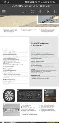

Just looking at the craftely changed wording between 2015 and 2016 Shuttle brochure.
Look at option/photo 08
2015 brochure suggests A.C. front and rear.
2016 brochure is worded differently. Suggests A.C. front but only heating in rear.
