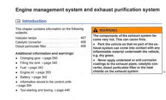

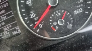

I'd always read it was the 1/4 mark, but according to that manual extract above, it is only when the Reserve warning light comes on. Is that 1/4?
Does the light come on at 1/8 Mark?

Thanks. I mean i had been fuelling a little here and there and it in all honesty has been topped up at prob a quarter of a tank at a time. However its over half now after reading it deep inside the manual that regen won't happen under a 1/4 tank and the advice on here.

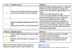

Regarding the DPF not doing a re-gen under quarter of a tank of fuel... mine has done one whilst the level is just above where the re-fuel light comes on. As the handbook shot shows, it should do this up to the point of the lamp illuminating for low fuel.

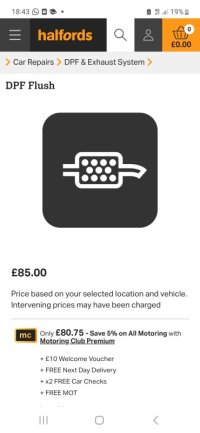

Has anyone ever tried a halfords £85 dpf flush..probably clutching at straws but worth asking...!!
If that's a fuel additive I'd doubt it would do much?
If carbon was so easy to dissolve there would be far less issues with power plant in general.
The only reliable method with an enclosed unit like a DPF is to push it back the way it came in - remove and back flush.
