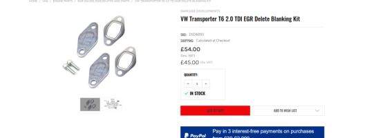

the deletes normally involve blanking plates being fitted on the EGR valve,

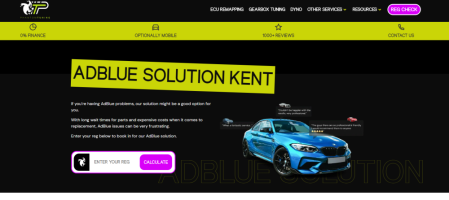

not sure about the adblue - software only? or maybe HW change?

eg:​
VW Transporter T6 2.0 TDI EGR Delete Blanking Kit​
PLEASE NOTE: ONCE BLANKED OFF THE VEHICLES ECU WILL NO LONGER GET A SIGNAL FROM THE EGR VALVE CAUSING THE EMISSIONS WORKSHOP LIGHT TO APPEAR ON THE DASH BOARD. WE CAN REMOVE THIS BY REPROGRAMMING THE EGR SOFTWARE ON THE ECU.​
DARKSIDE DEVELOPMENTS ACCEPTS NO RESPONSIBILITY FOR THE USE OF THIS PART ON THE PUBLIC HIGHWAY WHERE REMOVAL OF EMISSIONS CONTROLS IS PROHIBITED. IT IS THE CUSTOMERS RESPONSIBILITY TO ENSURE THEY COMPLY WITH RULES AND LAWS RELATING TO THEIR HOME COUNTRY​
eg:
ADBLUE DELETE
What Is Our AdBlue Solution?​
Our AdBlue solution removes the AdBlue fault codes form the ECU and stops the AdBlue system from needing to work.
This means if you have issues with your AdBlue, our solution will stop this from causing any symptoms with the driving, starting or running of the vehicle.
PLEASE NOTE, IT IS ILLEGAL TO DRIVE A VEHICLE WITH A TAMPERED EMISSIONS SYSTEM ON PUBLIC ROADS IN THE UK. THIS SOLUTION IS INTENDED FOR OFF-ROAD USE VEHICLES ONLY.
