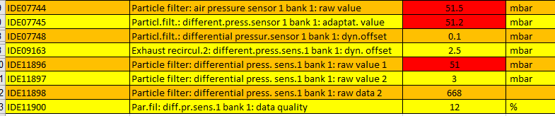

I do have VCDS
Please double-check the reading with VCDS - just to make sure the app is showing the value correctly.
Also would be interesting to see what the data items below show (Engine > Advanced Measurement Values) - engine ticking over.

IDE07744 Particle filter: air pressure sensor 1 bank 1: raw value
IDE07745 Particl.filt.: different.press.sensor 1 bank 1: adaptat. value
IDE07748 Particl.filt.: differential pressur.sensor 1 bank 1: dyn.offset​
IDE09163 Exhaust recircul.2: different.press.sens.1 bank 1: dyn. offset​
IDE11895 Particle filter: differential press. sens.1 bank 1: raw data 1​
IDE11896 Particle filter: differential press. sens.1 bank 1: raw value 1
IDE11897 Particle filter: differential press. sens.1 bank 1: raw value 2​
IDE11898 Particle filter: differential press. sens.1 bank 1: raw data 2​
IDE11900 Par.fil: diff.pr.sens.1 bank 1: data quality​
The bolded ones should be fairly close to what the app is showing.​

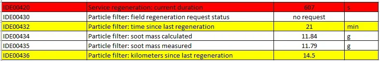

Hope this is correct.

Thanks - perfect!
Well, first some confusing data. Indeed, the engine seems to be in almost continuous DPF regeneration.
At the moment of the data capture the engine had already been in DPF regen for 10 minutes (607 s). Thus there had been only some 11 minutes of no-regen in between. Normally it's a few hours.
The "no request" is because the engine was just started.
As the regen is in progress the soot values will be decreasing fast - as soon as engine heats up. So can't conclude much about the values now. However, as soon as the regen is finished I'm expecting the soot measured to climb back to 24 grams just in minutes.
I think the pressure is way too high - indicating a blockage in the DPF. On cold engine (actually cold DPF) I would expect the pressure to be below 10 hPa.
Data confirms the readings what the VAG DPF app showed. The pressure loss in the DPF is really high - or the sensor has failed - however, the other values (offsets) seem to be normal.
Also air flow in the intake is almost double than normal so engine obviously is "labouring" even when ticking over. I think this might indicate that the DPF differential pressure sensor is actually just fine.
