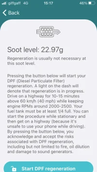

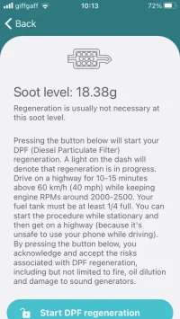

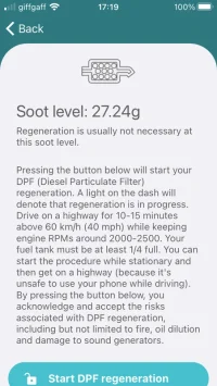

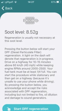

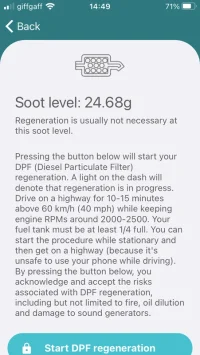

Sooo, I needed to pop to the shop today. Only about a mile away, but knew my soot level was about 30g.
Tank over half full, so thought I'd take it for a quick regen.
Practically started the regen out of the end of my road. Didn't wait for it to warm up, just started dumping fuel in and idle up at 1000rpm for longer than it should be. Started warming up real quick, and then started to reduce soot levels way before the engine was at full temp. then I got on A3 and it didn't really need revving above 2000rpm as it was constantly reducing.
Mine is a 2019, and had a software update in Nov 2020 specifically for the DSG delay, but who knows if any other trickery got uploaded at the same time.
Anyway, just reporting my experiences.
Also, in a totally non-scientific way, it looks like regens at idol or cold suck in loads of fuel as their primary goal is to get everything hot more quickly. Whereas on the run I don't even know it is doing it. I let it do it once outside my house idoling. Used about 25 miles of fuel based on my totally inaccurate assessment of the needle moving by a whole graduation!...
I love the fact Carista can tell me what is going on!

Interesting your van regens at 30g of soot, mine starts to regen at 24 and stops when it reaches 6g. Will be interesting to see if mine changes after the software update in a fortnight's time.
Yep, bang on 30 too, down to a little under 8. There will be some tolerance between the sensors and reader, so no idea how they calibrate them.
